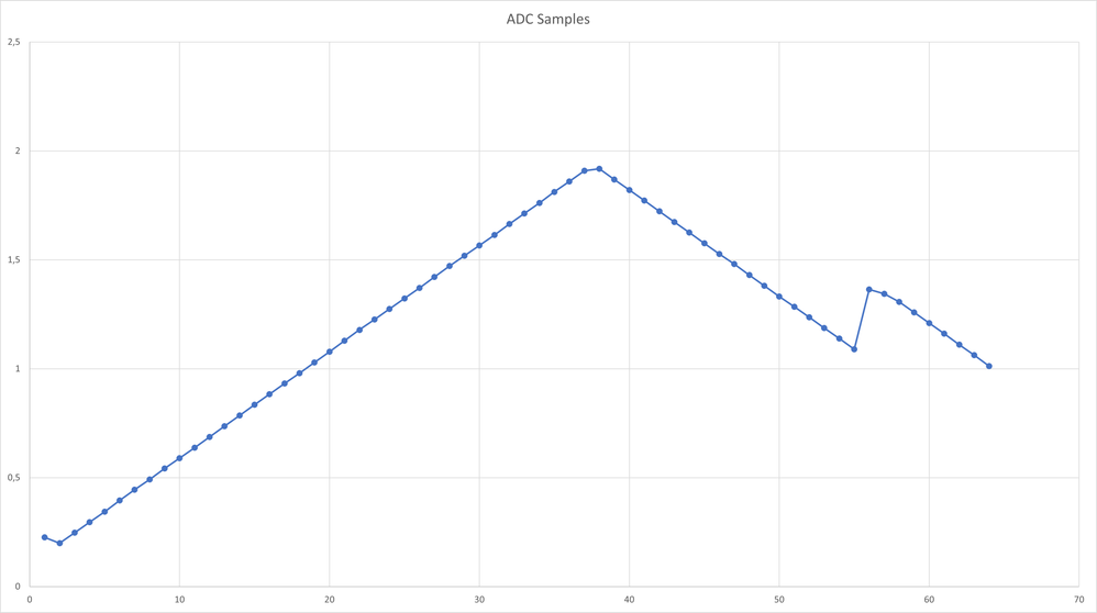

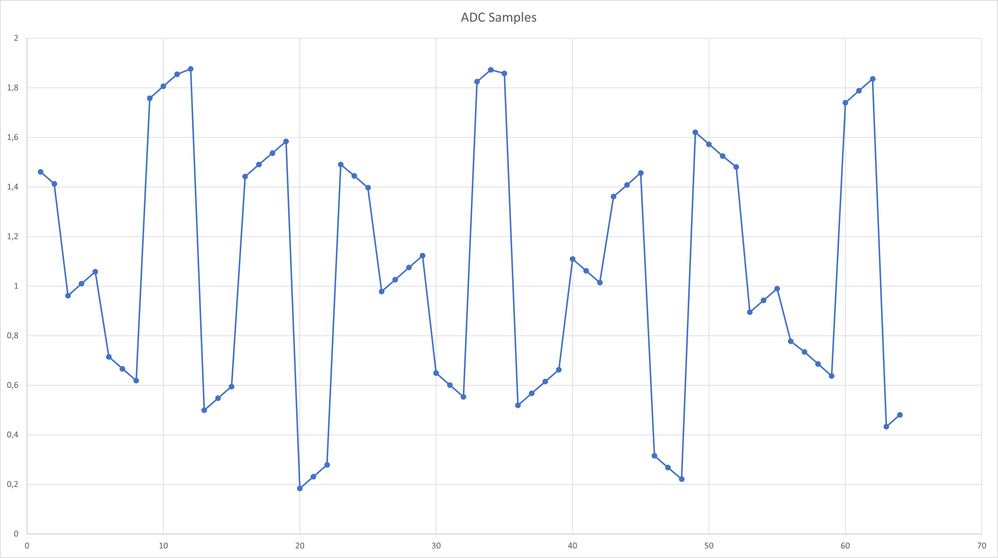

As you can see there are a lot of pauses in the DMA sampling? Anybody knows what could be wrong?
The buffer size is 64
The sampling rate is 5000 Hz

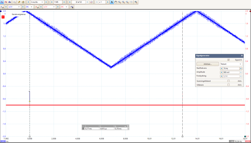

The input signal is a 70 Hz triangle.
ADC-input:
Sampling without DMA:
Samples with DMA:

The problem was this line:
Chip_DMA_SetSRAMBase(LPC_DMA, DMA_ADDR(Chip_DMA_Table));
it should have been this:
Chip_DMA_SetSRAMBase(LPC_DMA, DMA_ADDR(ADC_TransferDescriptors));
It was the wrong descriptors loaded into the DMA.
