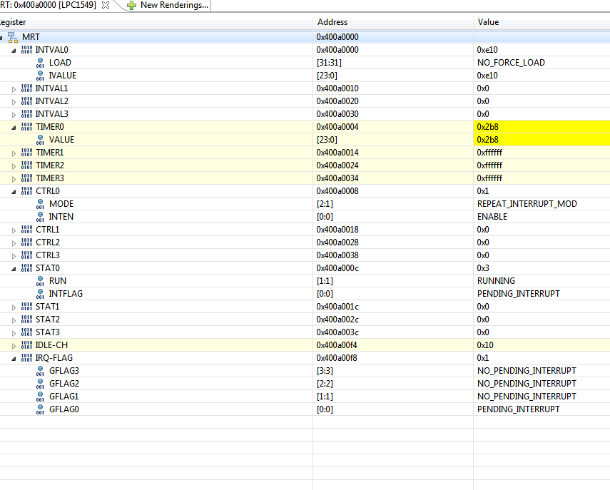

on a project with FreeRTOS and RTI i would like to add a MRT Timer.
The debugger shows the timer is running, interupt flag pending but the ISR is not  called.
Any idia?
For a first test a added the example code + the first 2 lines. NVIC_EnableIRQ(MRT_IRQn) at the end of the init fnchas also no effect.
void MRT_init()
    Chip_Clock_EnablePeriphClock(SYSCTL_CLOCK_MRT);
    Chip_SYSCTL_PeriphReset(RESET_MRT);
    int mrtch;
    Chip_MRT_Init();
    for (mrtch = 0; mrtch < MRT_CHANNELS_NUM; mrtch++)
        Chip_MRT_SetDisabled(Chip_MRT_GetRegPtr(mrtch));
    NVIC_EnableIRQ(MRT_IRQn);
    LPC_MRT_CH_T *pMRT;
    pMRT = Chip_MRT_GetRegPtr(0);
    /* Setup timer with rate based on MRT clock */
    Chip_MRT_SetInterval(pMRT, (Chip_Clock_GetSystemClockRate() / 20000) | MRT_INTVAL_LOAD);
    Chip_MRT_SetMode(pMRT, MRT_MODE_REPEAT);
    Chip_MRT_IntClear(pMRT);
    Chip_MRT_SetEnabled(pMRT);
void MRT_IRQHandler(void)
    uint32_t int_pend;
    /* Get and clear interrupt pending status for all timers */
    int_pend = Chip_MRT_GetIntPending();
    Chip_MRT_ClearIntPending(int_pend);
    DIO_SW2_TOGGLE;

andreasschnitze
Hi jermyzhou,
thank you. I took the example again its running now. . I obvious missed something and/or a breakpoint inside the isr for first ivestigation was optimiced out.
