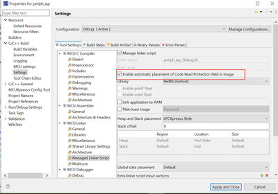

I 'm using LPC1313FHN33 to develop something,seeing that there exists a option called CRP.
I 'm wondering how the CRP's value generate in the IDE?
Should I select some check box to active that?Where can I set the CRP's Value?

Hello @GratitudeThanksGiving
You can enable as below if you use MCUXpresso IDE:
