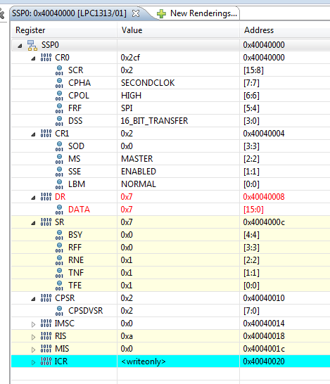

I am trying to set the bit rate of the SSP0 port of the LPC1313FBD48/01 to 1MHz. The system clock is 72MHz, and it is divided by 12 to have the SSP clock as 6MHz. I have checked the CPSDVSR = 2 and SCR = 2, which should give me 1MHz:
Bit frequency = Pclk/(CPSDVSR * (SCR + 1))
However, I get 781.2kHz in place of 1MHz.
What might be going wrong here?

I have tested with the same settings on another board and see that the bit clock gets set to 992kHz instead of 1MHz. The SSP0 registers are as below:
Please let me know if these values are as expected to achieve 1MHz bit rate.

prachipanse
Thanks. I have observed the system clock on the CLKOUT pin and it comes to be around 71-72MHz.

jeremyzhou
Hi prachi panse,
Thanks for your reply.
If the system clock is located in the range of 71 to 72 MHz, the observed frequency: 992kHz can be considered correct according to below formula.
Hope it helps.
