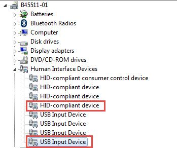

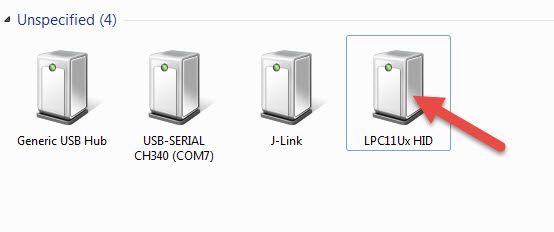

jeremyzhou
Hi Siva Kumar,
I've ran the usbd_rom_hid_generic demo which is from the lpcopen_2_12_lpcxpresso_nxp_lpcxpresso_11u68, it can be illustrated under the Human Interface Devices, and it also be found under the Devices and Printers.
So I've attached the descriptor set, you can refer to it for details.
                           Fig 1
                                                         Fig 2
Ping
