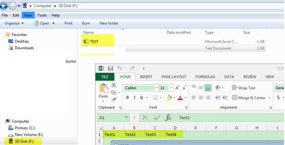

  If you want to create the .xlsx file, you can create the .csv file, then use the office excel, you can open it in the excel mode.
  Now, give you the main code how to open and write the .csv file.

Take care, change row, you just need to use ","
Just linke write:Test1 ,Test2 ,Test3 ,Test4 , it will have 4 rows.
Then, after you run it, you will get the excel file:
