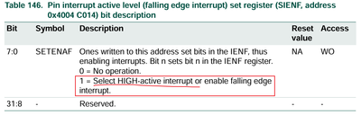

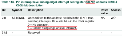

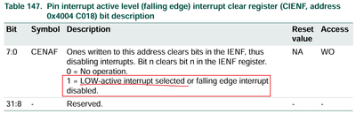

Dears,
I encountered a issue about active-level interrupt when I use #LPC11U35BFD# mcu. I use the command to control Ex-Interrupt mode and trigger
The similar init code, the edge(rasing or falling) interrupt and level interrupt work well, but the active-level(High or Low) interrupt doesn't work.
I use the command to switch the interrupt mode(Rasing, Falling, High-Level, Low-Level).
NVIC_DisableIRQ(FLEX_INT0_IRQn);
LPC_GPIO_PIN_INT->ISEL  |= (1UL << 0); //Level sentisive
LPC_GPIO_PIN_INT->CIENR |=  (1UL << 0);  //close level interrupt
//Those two configurations only execute one.
LPC_GPIO_PIN_INT->IENF |=  (1UL << 0);       //enable High Level Interrupt
LPC_GPIO_PIN_INT->IENF &=  ~(1UL << 0);   //enable Low Level Interrupt
LPC_IOCON->PIO0_2      |= 0x10;
LPC_GPIO_PIN_INT->RISE |= (1UL << 0);
LPC_GPIO_PIN_INT->FALL |= (1UL << 0);
LPC_GPIO_PIN_INT->IST  |= (1UL << 0);
NVIC_EnableIRQ(FLEX_INT0_IRQn);

Andy2022
Hi Alice_Yang:
Thanks for your reply.
The Level interrupt works well (High->Low and Low -> High both trigger an interrupt ).
However, I only set High-Level interrupt or Low-Level interrupt, the corresponding operation can't trigger an interrupt.
Thanks very much.
