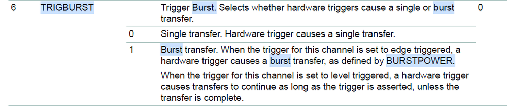

OK, I've actually got this running, through a lot of trial and error.
It seems there's two essential things:
    Chip_DMA_SetupChannelConfig(LPC_DMA, DMAREQ_SSP0_TX, (DMA_CFG_PERIPHREQEN |DMA_CFG_SRCBURSTWRAP));
then
    Chip_DMA_SWTriggerChannel(LPC_DMA, DMAREQ_SSP0_TX);
I'm not sure about the xfercfg portion, but it seems to work.

Adding DMA_CFG_PERIPHREQEN doesn't seem to do anything. I get maybe one word stored. The only way to get it store anything and issue an interrupt is by calling Chip_DMA_SWTriggerChannel(), which isn't what I want.
EDIT: The LPCopen11U68 has no example for SSP and DMA. There's a UART & DMA, which is exactly what I based my code on.

Hello Chris,
If you want to "it just needs to be continuous", how abut use Burst transfer mode:
The following example show how to configure the channel for peripheral
 *            DMA requests, burst transfer size of 1 (in 'transfers', not bytes),
 *            continuous reading of the same source address, incrementing destination
 *            address, and highest channel priority.<br>
 *            Example: Chip_DMA_SetupChannelConfig(pDMA, SSP0_RX_DMA,
 *                (DMA_CFG_PERIPHREQEN | DMA_CFG_TRIGBURST_BURST | DMA_CFG_BURSTPOWER_1 |
 *                DMA_CFG_SRCBURSTWRAP | DMA_CFG_CHPRIORITY(0)));
About detail you can check UM 10732 and DMA demo under LPCopen.
