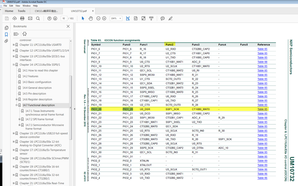

I am looking at using the LPC11U68 in a product. I need USART0 and 1 and the SPI (SSP) 0 and 1.
With regards to the USART0, I just need the TX, RX, CTS and RTS.
My question is, should I allocate the DSR0 (PIO1_20) to the SSP1_SCK in the pins function register, what will be the 'state' of DSR0 that the modem control register will see?
Does it see it as permanently ready?
Thanking you in advance

If you want to use the PIO1_20 as the SPI_SCK pin, you must configure the digitial pin control register, FUNC=2, because func2 is the SSPI1_SCK pin, you can find it in the user manual,
Table 83. IOCON function assignments.
Then it is no relationship with the DSR0 function, it is controlled by the SPI module now.

kerryzhou
Hi Gordon,
    If you change PIO1_20 function from DSR to SPI_SCK, the DSR function won't work any more, unless you choose the DSR pin for the UART module.
Kerry

kerryzhou
Hi Gordon Jefferies,
   You can find in the register, after reset, the data is 0 in default.
   But, if you run some codes, then want to know the DSR data, you can read MSR[DSR] directly.
   Actually, you can debug it on your board, then you will get the result which you want.
