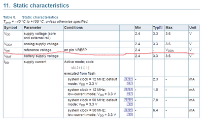

In the LPC11E66 user manual it is claimed the 12 bit adc will "give best performance" when Vref is the same as Vdda.  I am using Vref = 2.5V and Vdda = Vdd = 3.3V.  Both are well filtered.  Can someone please give more detail on what specific degradation(s) can be expected in my situation?

As the Table 8. Static characteristics, the Vrefp voltage ranges from 2.4V to VDDA, I suppose it is okay to connect 2.5V to Vrefp with 10uF decoupling capacitor.
I have not seen anywhere that it is mentioned that "the 12 bit adc will "give best performance" when Vref is the same as Vdda. Can you tell us where the remark is written?
