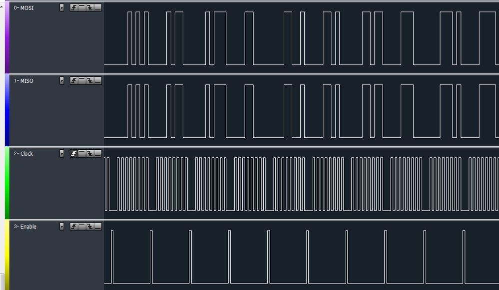

We have a project where we need SPI.
We have full communication using bitbanging, but we can't get it to work using the peripheral.
On the logic analyser all signals seem to be correct (and identical to bitbanging, except timing), but the read register is empty.
What are we doing wrong?

I did a test with the OM13093 LPCXpresso board for LPC11C24 using <lpcopen_v2_00a_keil_iar_nxp_lpcxpresso_11c24> software package with [periph_ssp] demo.
For I only have one OM13093  board on hand, I short connect the LPC11C24 PIO0_8(MISO) & PIO0_9(MOSI) together.
I disable the LOOPBACK_TEST macro definition.
After the demo code run, I could find Rx_Buf array with Tx_Buf array value:
The SPI analyzer also shows the MOSI with the same data of MISO:
I think you could refer this [periph_ssp] demo as a start point.

chrisidema
It is the PN532 NFC reader. But even connecting MOSI to MISO gives an empty result.
Like I said we got it working with bitbanging, but want to get the spi peripheral working (also for other projects).
The read sequence may not be correct in this particular snippet, but we should get a result other than 0.
