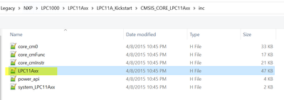

I've found legacy support in MCUXpresso installation: ..\ide\Examples\Legacy\NXP\LPC1000\LPC11Axx
which contains file named LPC11Axx.h which is somewhat similar in its content to cmisis_11uxx.h from the  lpcopen_v2_03_lpcxpresso_nxp_lpcxpresso_11u37h.
I'm missing something? Am I suppose to marge the two in someway? Or is there a LPCOpen for LPC11Axx family that I'm unable to find?

I've used LPC11Axx.h to "create" missing cmsis_11axx.h. What worries my is that I had to use "#define ENABLE_UNTESTED_CODE" macro to build the project. It all feels extremely flimsy and makeshift.

You can see there is a legacy folder under IDE, it includes lpc11Axx.h :
C:\nxp\MCUXpressoIDE_11.6.0_8187\ide\plugins\com.nxp.mcuxpresso.tools.wizards_11.6.0.202112161359\Examples\Legacy\NXP\LPC1000\LPC11Axx

Sorry there isn't a LPCOpen for LPC11Axx family .
"LPC11Axx.h which is somewhat similar in its content to cmisis_11uxx.h "
->> Yes, you can use LPC11Axx.h instead of cmsis_11uxx.h.
About other two files "- acmp_11xx.h - dac_11xx.h", do you need ACMP and DAC component, if yes, you can tell me, I send to you. If no, just comment them.
