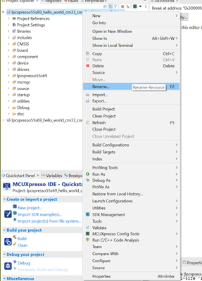

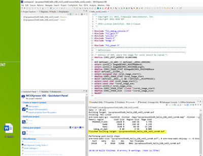

Refer to your description, test on my side, use hello_world demo, project  original name as below:
After change:
you can see there is no error in Console.
Steps as below:
1) Change master and slave project name:
2) Re-build slave project,

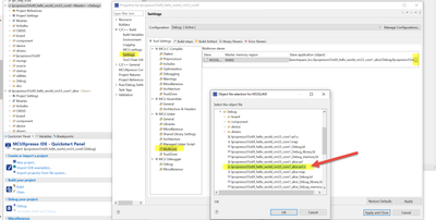

3)Change Slave object in Master project:
4) Build Master project.

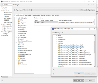

" 1) After change slave project name, please clean this project, then build again. "
" 2) In Master project, refer to below picture change to your new named .axf.o file "
2) In Master project, refer to below picture change to your new named .axf.o file :
