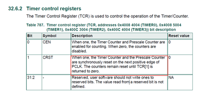

Pls refer to section 32.6.2 Timer control register, you have to set the CRST bit, then wait for the bit cleared. so it takes a long time to wait for the bit cleared.
The code is correct.

I have read section 32.6.2.
It states:
"When one, the Timer Counter and the Prescale Counter
are synchronously reset on the next positive edge of
PCLK. The counters remain reset until TCR[1] is
returned to zero."
So it should be reset on the next positive edge of PCLK. Seeing as PCLK is running at 122.88MHz on my board, this should take just over 8nS. Not anything like the values I am seeing:
"with no optimisation it takes 480nS but when I call it with -01 optimisation it takes 1.76uS"
Please can you explain why this is so?
I would also like an explanation of Chip_TIMER_Reset(), in particular why it sets the TC to a not zero value before the reset? There is no explanation for this in the manual?
