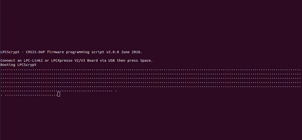

When I to program the LPC Link2 with the script program_CMSIS the console is not responding (in bionic beaver)
99-lpcscrypt.rules
 # NXP LPC (unbooted LPC18/LPC43 device waiting for DFU)
SUBSYSTEM=="usb", ATTRS{idVendor}=="1fc9", ATTRS{idProduct}=="000c", MODE="0666"
# LPC18/43 running the lpcscrypt firmware
SUBSYSTEM=="tty", ATTRS{idVendor}=="1fc9", ATTRS{idProduct}=="0083", MODE="0666"
# stop the ModemManager from trying to use this port as a modem!‍‍‍‍‍‍‍‍‍‍‍‍‍‍‍‍‍‍‍‍‍‍‍‍
dmesg
[65653.379350] usb 3-2.4: new high-speed USB device number 13 using xhci_hcd
[65653.579860] usb 3-2.4: New USB device found, idVendor=1fc9, idProduct=000c
[65653.579868] usb 3-2.4: New USB device strings: Mfr=1, Product=2, SerialNumber=3
[65653.579872] usb 3-2.4: Product: LPC
[65653.579876] usb 3-2.4: Manufacturer: NXP
[65653.579880] usb 3-2.4: SerialNumber: ABCD‍‍‍‍‍‍‍‍‍‍‍‍‍‍‍‍‍‍‍‍‍‍‍‍‍‍‍‍
The boot is ok
./boot_lpcscrypt
 Looking for DFU devices with VID 1fc9 PID 000c ...
dfu-util -d 1fc9:000c -c 1 -i 0 -t 2048 -R -D /usr/local/lpcscrypt/scripts/../bin/LPCScrypt_227.bin.hdr
Booted LPCScrypt target (1fc9:000c) with /usr/local/lpcscrypt/scripts/../bin/LPCScrypt_227.bin.hdr‍‍‍‍‍‍‍‍
If I use ./lpcscrypt queryblock I get No serial ports.
In tty I have not created anything tty terminal as ACMn or USBn. It's necessary?

9,685 Views
jeremyzhou
Hi Javier Hernandez,
On my site, the revision is Ubuntu 16.04.05 LTS, maybe you can give a try.
Meanwhile, I'd like to suggest you record the steps of programming the LPC Link2 by the script program_CMSIS, then upload it to the Youtube or other websites, and share me the link, as as I want to figure the error out.
TIC
