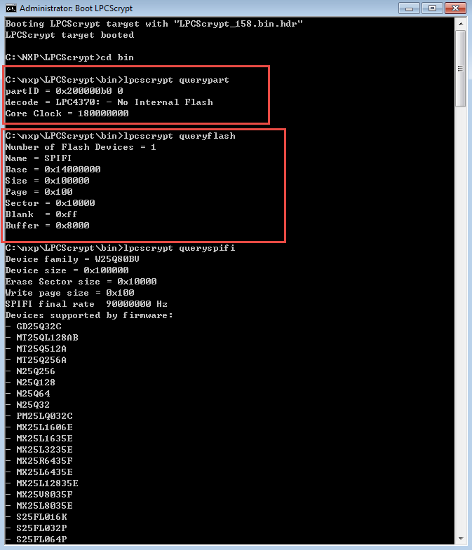

kerryzhou
Hello Juan Abelaira,
   Now, please follow my steps to check the LPCLINK2 detail problems:
1. Remove the jumper on JP1
2. Open Boot LPCScrypt under your lpcscrypt
3. Input: cd bin
4. input: lpcscrypt querypart
   just check whether the LPC4370 have problem or not.
5. input: lpcscrypt queryflash
   Just check whether the on board external flash have problem or not.
 This is my test result:
Please check it at first, and give me you screenshot.
Waiting for your reply!
Kerry

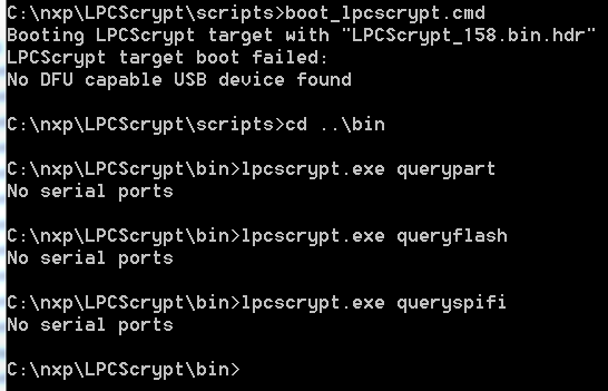

juanabelaira
Thanks Kerry, below is my result, basically the USB is not recognised.
4,417 Views
kerryzhou
Hi Juan Abelaira,
     When remove the JP1, and open device and printers in the control panel, can you find the LPC device?
If the LPCscript still useless, I think your on board LPC4370 maybe damaged, not just the software lost problem.
Kerry
