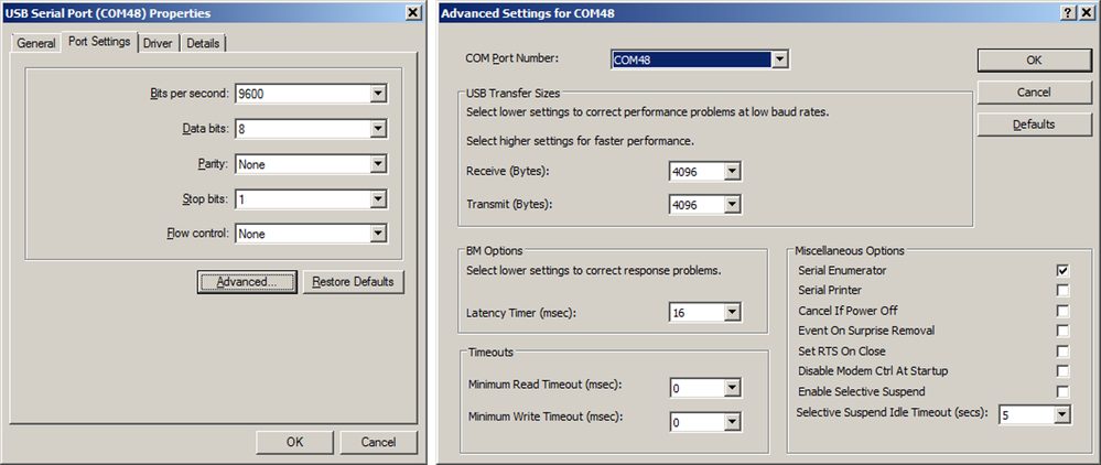

I have a number of legacy LPC2xxx devices that often need to have their firmware updated via 9pin serial connections.  Previously we had been using onboard serial ports on our laptops along with the LPC2000 Flash Utility.  Recently we upgraded to Windows 10 systems that have a docking station with a 9 pin serial port built into t them, but theya re being reported as USB serial converters, and while the Flash Utility will recognize that the hardware is on the other end of the serial cable, it is choking when I actually try to push the firmware to the controller memory.
I am looking for another utility that can better handle the USB / Serial adapters for this product.
Any suggestions?

For the Flash Utility:  maybe you can play around with the Virtual COM Port FIFO settings in the Windows Device Manager, sometimes this helps. But most likley the way the old Flash Utility talks to the Windows API is simply too old fashioned :-)

Do you get any options for these docking station ports like the ones I get for the FTDI cable?
I see quite some options in there which seem to be worthwhile to play with.
For me this looks like a race condition, if it's possible to relax and slow down some things it might work better.

Berhard:  Many thanks for the suggestions.  I have been wirking with a Dell developer on this issue, and we have indeed worked through theses settings, but still cannot make the program detect or upload the firmware to the controllers through the USB Serial connection.  This is after upgrading the computers BIOS, changing the driver for the serial port from the oldest Dell driver through all available Dell drivers currently in their archives up to and including the most recent driver.  We have also downloaded a driver from the FTDI website and tried these.  We have gone through all BAud rate settings, made changes to the receive / transmit timings, changed the timeout period on the software, and also made changes to the timing chip setting within the Philips Flash utility.
None of those changes allowed the program to connect to the controller chip through the USB Serial connection on the Dell Rugged Docking serial port.
If, however, we attach the serial cable to the built in serial port on the laptop, then the program immediately connects at speeds up to 57000 baud, and is able to push the firmware into the controllers.  (There are two primary controller chips in the equipment we are working on; LPC2292 and LPC2119. The LPC2119 devices will allow connections at 57K baud and the 2292 controllers limit the connection to 38k Baud.)
So, of course the big question is why would we need to use the docking station instead of the built in serial port?  Well, the port is hidden behind a hinged dust cover that is (for a supposedly rugged machine ) is surprisingly fragile.  In fact, we have already had two of these flapped doors break off in our garage environments.
Fortunately, I have been able to get a copy of the Flash Magic software and have been able to create new "saved settings" files for the four devices and this tested the ability to communicate through the docking station serial ports.  This program is perfectly happy to communicate through the docking station serial port to the LPC controllers, and is even two steps easier for the users to complete the flash programming.
