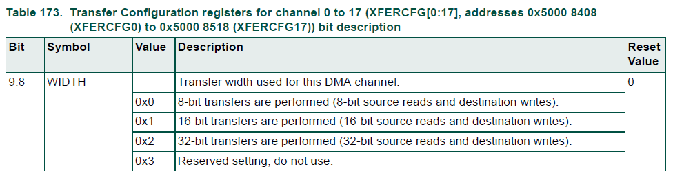

"If there is a 8-bit or 16-bit transfer, will there be one read/write of RAM for each transfer or will it be 32-bit transfers to RAM?"
-> You can config the transfer width:
TIC
