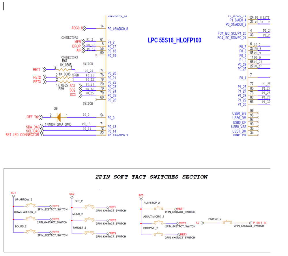

Here a PIN has been configured as OUTPUT. We try to give 3.3V externally to that configured PIN. It leads to controller freeze or reset problem. Kindly give the points to avoid this problem. This problem not happens in LPC 1788, LPC 1768.
This happens while developing application for the matrix keypad

xiangjun_rong
Can you post the related part of schematics so that we can have a review?

Dhaya
Here is our customized board schematic

xiangjun_rong
If you change the serial resistor as 10K ohm for the R67, R68, R69, does the Resetting or freezing happen or not?
I am not clear about the SC1, SC2 and SC3 nodes, are the SC1/SC2 and SC3 driven only by P0_23,P0_24 and P0_25 or by external source?

Dhaya
Thanks for reply .
Yes, even if the resistor value changed to 10KOhm freeze problem was happened.
SC1, SC2, SC3 is nothing but the column control of matrix keypad. These three are driven only by the P0_23, P0_24, P0_25 (which are configured as output). There is no external sources for these PINS

5,346 Views
Dhaya
Thanks for help. It is solved by tried the methods you given.
By include the resistor value 10K on both SC and RET PINS, it not get into freeze/Reset mode .It becomes works in ideal state
