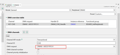

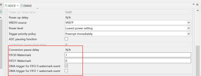

Q3: ", this signal does not appear in the list of signals under ADC0"
->> How about refer to below picture:

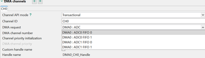

Q4> On my side, there is no  ADC0_TCOMP0 under DMA request list:
