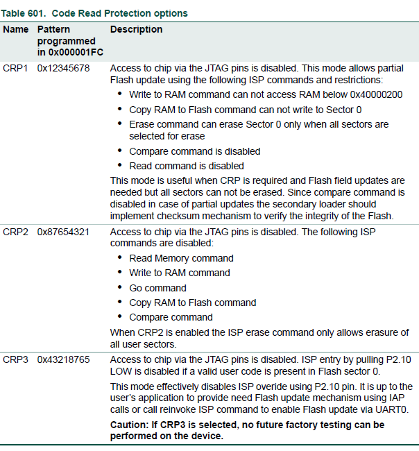

We have LPC 2468 with internal flash and need to reprogramme with our code by ISP. Probleme is, that IC is locked and setted security...Is a way to un-lock device, erase  and burn new code. We use Flash Magic ..

You mean the CRP has been implemented? if CRP1/2 is set, you can use FlashMagic to erase the flash.
If CRP3 is set, ISP mode only can be entered by user code.
Hope this will be useful for you.
