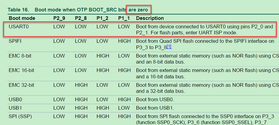

I have LPC183x-Xplorer development board, I am working to verify ISP firmware download over UART0 using P2_0 & P2_1 pins available on header J8.
I have put the board in ISP mode by pressing SW2 switch at reset, I see D3 (Blue LED glowing) indicating that it entered ISP mode.
I opened Tera-Term @ 9600 and entered character "?" from host, I did not receive any message from device :smileysad:
I also tried to program using Flash-Magic tool, after bringing board in ISP mode. I see the below error
Bit mode selection pins P2_9, P2_8, P1_2, and P1_1 = 0,0,0,1 with boot select switch J4
Please let me know If I have missed any thing in the procedure. Thanks in advance.

Hi Vamshi krishna,
    Please take care this point:
  So, please put all the switch in J4 in the ON side.
  Then, connect PC COM TX to board J10_26, PC COM RX to J10_16.
  Enter ISP mode by pressing SW2 switch at reset.
Now, use the flash magic to search the board again, I can find the signature with the above steps.
Please modify the J4 connection, then try again.
Wish it helps you!
If you still have question, please let me know!
Kerry

Thanks for the information, I was just biased by the below pin out description
I was using U0_TXD and U0_RXD hi-lighted in red which do not corresponds to P2_1 & P2_0 (realized and confirmed on your reply), after using right GPIOs that is GPIO5[0] & GPIO5[1] I am able to program using FlashMagic.
