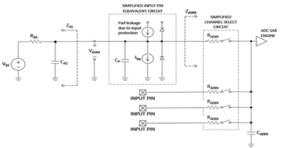

I can't find the ADC maximum external input impedance of LPC5502 in datasheet  .

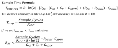

After checking internally, the datasheet's input resistance value means RADIN as it is shown on the next diagram:
So, the maximum external ADC input impedance calculation can be obtained with the formula below:
In case that you do not want to calculate it by yourself, use attached excel table that can be helpful to speed the calculate up.
Please let me know if you have more questions.

I found the datasheet spec of "2k input impedance" confusing, assuming it meant a 2k resistance to ground, but it actually means that there is 2k in series with the S&H capacitor.
The time constant of (2k+your_source_impedance) * 5pF input capacitance should be compared with the sample period (1/sample_rate)
three time constants = sample period will give you 5% accuracy
five time constants = 1% accuracy
11 time constants for full 16 bit accuracy
