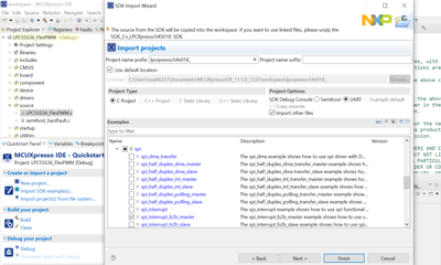

Regarding the firmware, pls download SDK package from the link:
https://mcuxpresso.nxp.com/en/welcome
You can refer to the example of SPI, you can click driver_examples->spi
Hope it can help you
