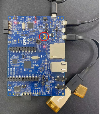

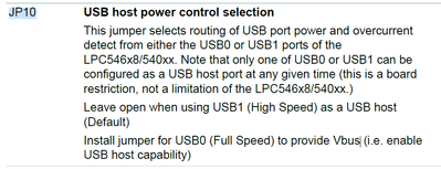

To work with USB FS host, please make sure JP10 installed to provide vbus to USB0
We don't have guide of configurate pen drive.
I ever wrote article of Using ConfigTool to create USB Project From Start. You can refer it to play your own application.

ZhangJennie
I alreay tested.
With a correct demo board setting (as I showed in previous photo), I can see the same output as readme.pdf file shows.
If the jumper setting is not correct, it's possiable only see host init.
The demo code has no issue, please check your board jumper setting, or test it with another demo board.

Thanks ZhangJennie,
I was missing the JP10 connection. As you said, the NXP example works perfectly, as it is.
I overlooked your suggestion, which was provided long back. Appreciate your support!
