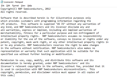

lpestanas
Hi Zhang,
Given that LPCOpen is an open-source,
a. did NXP released a driver that was tested across Optimizations (let us say Optimization level 0. 1. 2 and 3)?
b. Is the user of LPCOpen allowed to alter the contents to make it Optimization Level 3 without any software licensing implications regardless of purpose whether it will be a commercial or personal use only?
Leo
3,877件の閲覧回数
ZhangJennie
HI lpestanas,
We don't have driver  tested across Optimizations.
LPCOpen copyright is anounced as below which should answer your question. You can also find this file under LPCOpen install folder.
Jun Zhang
