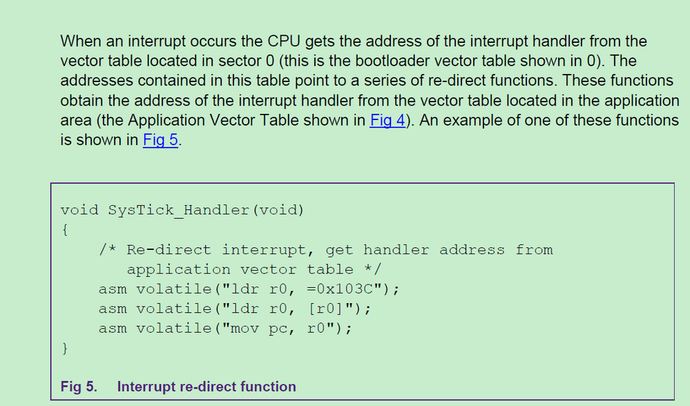

dawidstysiak
Your code give me Hard fault. My code works but after jump back to main application SysTick interrupt does not work. I don't know why.
I have to change line:
LDR  sp, [r0, #0]    ; Get app stack pointer
to
stackPointer = *(uint32_t*)(0);
__set_MSP(stackPointer);
due to compiler error.
4,695 Views
kerryzhou
Hi Dawid,
    Sorry for my later reply!
  The code which I give you is from above Cortex M0+,  because the Cortex M0 don't allow the vector table to be remapped, the vector table is  located in the same area of flash memory as the secondary bootloader, so customer should redirect the functions by themselves.
  Actually, we have an application about it, please refer to AN10995 :LPC1100 secondary bootloader.​
page7
Please redirect the systick handler to your application code.
Wish it helps you!
If you still have question, please let me know!
Jingjing
4,695 Views
