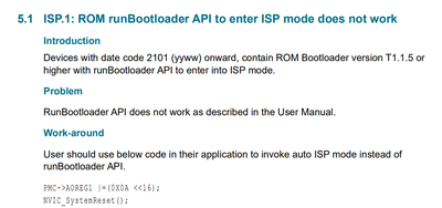

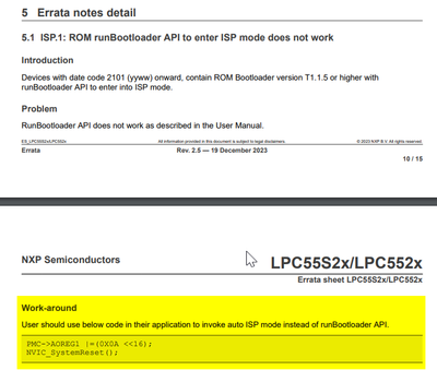

nxf64834
Please refer below snippet from Errata for tried and tested method to enter ISP mode from application.
Thanks.
7,336件の閲覧回数
tks11111
As we discussed previously, I tried this method and it did not work.
That is why I asked for another method to enter ISP mode from the application.
The workaround method I used was to wire a capacitor between P0_5 and GND, and set P0_5 to digital low before I called NVIC_SystemReset(). This way, the IC detected P0_5 low and entered ISP mode.
However, this method had some flaws because we might need to add a capacitor and wait for the discharge time.
I wonder if there is any method that can enter ISP mode without adding any components.
Thanks.
BR,
Peter

7,488件の閲覧回数
Hello @tks11111
What is the date code of your device? You can find on marking of your chip.
And there is issue with  date code 2101 (yyww) onward, detail:
https://www.nxp.com.cn/docs/en/nxp/errata/LPC55S2x_LPC552x_ES.pdf
Alice
