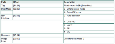

Following the user manual, I have the following code in my application to enter ISP mode but all it's doing is reset the system and start from the beginning of my application. Do any of the configurations inside CMPA/CFPA affect the ability to enter ISP mode. CMPA/CFPA are not currently configured (all zeros). Is there anything that needs to be set within my application before jumping to bootloader (runBootloader).
#include "fsl_iap.h"
int main()
    // ISP mode and USB only (LPC55 User Manual section 9.3.4: runBootloader API)
    uint32_t arg = 0xEB110000;
    RunBootloader(&arg);
    while (1) {}
I added RunBootloader declaration/definition in  fsl_iap.h/c:
void RunBootloader(void *arg)
    BOOTLOADER_API_TREE_POINTER->runBootloader(arg);
fsl_iap already has the following definitions:
#define BOOTLOADER_API_TREE_POINTER ((bootloader_tree_t *)0x130010f0U)

Best Way to do it is as below:
LPC55S16 ROM bootloader provides an API for the user application to enter the ISP mode based on the designated ISP interface mode.
Prototype
void (*runBootloader)(void *arg);
add the below code in fsl_iap.c:
#define BOOTLOADER_TREE_LOCATION(0x1301fe00)
bootloader_tree_t *romApiTree = (bootloader_tree_t *)BOOTLOADER_TREE_LOCATION;
void runBootloader(void *arg)
    romApiTree-> runBootloader(&arg);
then in the main, add:
uint32_t arg = 0xEB110000; // Boot in ISP and ISP interface will be USB-HID
runBootloader(arg);
After that ROM Bootloader will boot in ISP Mode, and you can flash through USB-HID.
Note: The above approach is tested and verified on LCD55S16.
