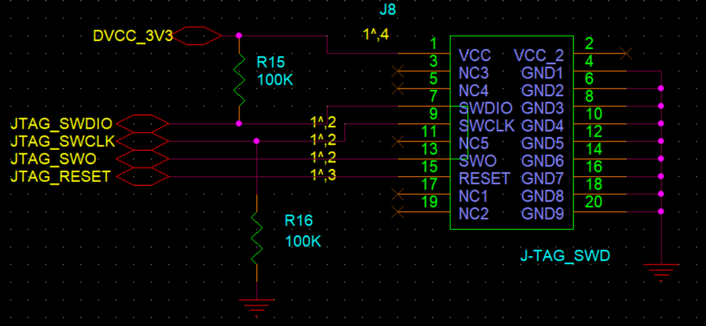

I have made lpc55s69 pcb,and the debug interface on board is JTAG-SWD type.I placed an 100K Ohm pull-up resistor over the SWDIO pin and a same value pull-down resistor on SWCLK pin,referenced to the official EVK.
But when i tried to debug an example project on it with jlink,errors occured.It said:"JLink cannot connect to target"
The software i use is MCUXpressoIDE 11.0.1.
But it seems that my JLink has recognized the mcu,however , just cannot contact with it.
Could anybody tell me whether I made my circuit correct or not ?

1) But it seems that my JLink has recognized the MCU, however, I just cannot contact it. Could anybody tell me whether I made my circuit correct or not?
-- After having a review of the schematic and the command in J-link Commander, I think the schematic is right basically, however, I don't consider the J-link had already recognized the LPC55S66 actually.

I recently spent some time getting my LPC55S66 up on my board.
Did you pull the RESET pin up with a resistor (any value from 10K to 100K should be fine)?
