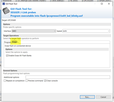

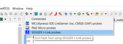

Does your board can work well before?
If yes, please erase all flash first, then re-connect board, debug.
Erase steps as below:
Alice

As a sidenote, the JLink driver installation usually comes with several tools, including a "J Flash Lite" application, which could be used standalone for this purpose.
Usually found under Programs->Segger-J-Link.

Nadia
Error..
13,676 Views
Nadia
I can't delete it.
This is my first time using this microcontroller. I used to work with the LPC546XX, and I had no problems. Now I am working with the LPC55SXX, and I am not able to load the program.
