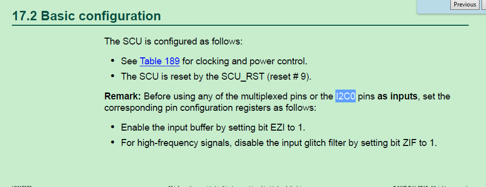

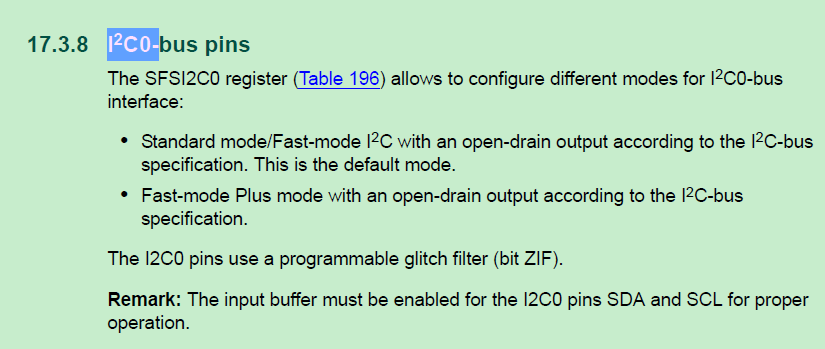

kerryzhou
Hi Neha Gandhi,
  From the lpc43s37 user manual,  you can find this remark:
Did you take care of it?
Besides, please change the external pull-up resistor to 4.7K to 10K, then try it again.
After you test it, if you still have question, please also give me your I2C0 wave in the I2C0 pin.
Wish it helps you!
Kerry

nehagandhi
Hi @kerry Zhou,
I have done the below configuration for I2C0
#define I2C0_STANDARD_FAST_MODE        (1 << 3 | 1 << 11)
I have tried using #define I2C0_STANDARD_FAST_MODE        (1 << 3 | 1 << 7 | 1 << 11) as well
Chip_SCU_I2C0PinConfig(I2C0_STANDARD_FAST_MODE);
STATIC INLINE void Chip_SCU_I2C0PinConfig(uint32_t I2C0Mode)
    LPC_SCU->SFSI2C0 = I2C0Mode;
But the clock is going low while executing the below function
STATIC INLINE void startMasterXfer(LPC_I2C_T *pI2C)
    /* Reset STA, STO, SI */
    pI2C->CONCLR = I2C_CON_SI | I2C_CON_STA | I2C_CON_AA;
    /* Enter to Master Transmitter mode */
    pI2C->CONSET = I2C_CON_I2EN | I2C_CON_STA;               <-- Clock will go to low after executing this statement
I am getting the below values in these registers
CONCLR = 1101000
CONSET = 1101000
I use to lost the control while executing the below statement after this function call
iic->mEvent(id, I2C_EVENT_WAIT);
I have connected 10K resistor in place of 1K as suggested by you. But nothing works out.
As the clock goes low after executing the above statement, I am not able to generate any particular waveform.
Please let me know, If i have to do anything else further on this.
