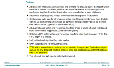

From the I2S chapter in the LPC55S69 User Manual (UM11126) Rev 2.1, section 37.2:
  • TDM (Time Division Multiplexing) with a several stereo slots and/or mono slots is
supported. Each channel pair can act as any data slot. Multiple channel pairs can
participate as different slots on one TDM data line.
Here is a diagram from the same section in the same manual with an example TDM frame with more than four slots:

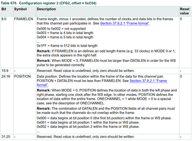

The “position” field in I2S CFG2 is used to specify the starting bit position for data within a frame.  This information is provided, once again, in the same section in the same manual (UM11126) Rev 2.1:
Additionally, as I have clearly indicated twice already, I ALREADY HAVE THIS WORKING, TESTED, AND HAVE ZERO PROBLEMS with two I2S ports servicing a TDM frame with four 32-bit slots.

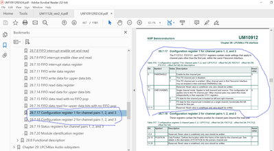

xiangjun_rong
Regarding your remark "the slot numbers refer to the TDM frame, so the 32-bit slots are slot 0, 1, 2, and 3 within a 128-bit frame.", I have said that the I2S module of LPC55xx only supports two slots for example I2S mode with two slots slot0,slot1, slot0,slot1,slot0...., it can not support TDM mode with 0, 1, 2, and 3 within a 128-bit frame. You can generate the Frame with 128 bits, but the data in FIFOWR can not drive to SDA pin for slot2 and slot3.
Because the slot2 and slot3 requires additional registers to control.
I copy the part from UM10912.pdf for LPC546xx, the I2S of LPC546xx can support 4 channels or 8 slots at most.
Hope it can help you
XiangJun Rong

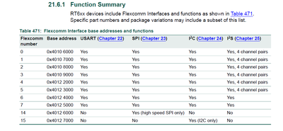

xiangjun_rong
Pls refer to Section 32.5.1 Function Summary in UM11126.pdf, for LPC556x/552x, the I2S module just supports two slots I2S, it do not support multiple slots TDM mode.
But the mimxrt600 family support at most 8 slots TDM mode as the following Pic, I copied from UM11147.pdf.
The additional channel requires  more register.
For the LPC553x, there are two FC modules FC6 and FC7 which support 8 slot TDM mode.
XiangJun Rong
