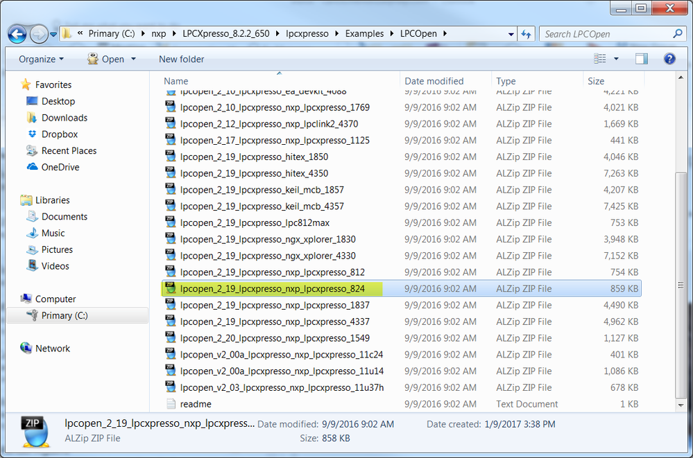

Carlos_Mendoza
Hi Valerio,
You can use the hello world example from the LPCOpen package or the example code bundle:
 https://community.nxp.com/external-link.jspa?url=http%3A%2F%2Fcache.nxp.com%2Ffiles%2Fmicrocontrolle...
Hope it helps!
