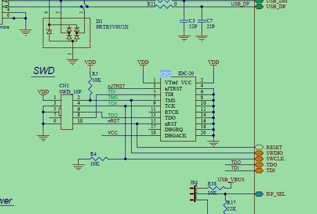

I am working on a development using LPC11E67JBD48. I am new to micro controllers . could any one let me know how to provide a pins for a programmer to program this Micro.  I am trying to interface TF16001A-V0 LCD to this micro.
I am attaching my schematic so if any one can review and let me know your comments.
thanks for your support.
Karthik

Hi Karthik,
Thank you for your interest in NXP LPC product, I would like to provide service for you!
For a programmer, you can use SWD or JTAG interface.
About the pins, please refer to this picture:
I also attach a LPC11U67 schemtaic for your reference, this schematic also contains the LCD interface, you can refer to it.
For the smallest system, please also refer to the attached schematic.
Wish it helps you!
