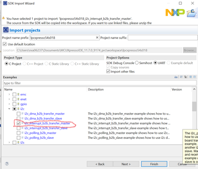

In SDK example, there is I2C example.

Hi @xiangjun_rong ,
What if we try in the I2C polling method?.Because I was actually try in the I2C polling method.Where I was got only slave address but not got a register address and the data.
3,334 Views
xiangjun_rong
If you use the polling mode, you have to write register and develop the code yourself.
