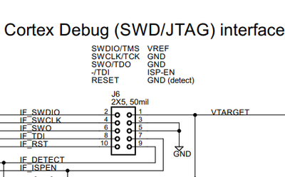

Where is the pinout for the 2x5 pin connector on the MCU-LINK board? Is it identical to Atmel's connectors? I have guessed so, but haven't found any documentation so I'm not sure. And what wires should be connected? GND, SWDIO and SWCLK are obvious, but do I also need to connect RESET and ISP pins, and if so, to which pin on the 2x5 connector?

Thanks! Ok I found the pinout, here it is (below) if anyone else is looking for it:

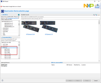

As for mcuxpresso I think it doesn't support the LPC11xx processors, at least I can't identify any line matching the LPC1114 in this list: https://www.nxp.com/design/software/development-software/mcuxpresso-software-and-tools-/mcuxpresso-i...

It is supported with 'preinstalled MCUs', if you create a new project:

As for the SWD connector pinout of the MCU-Link: have you checked the schematics of the board (available on the MCU-Link web page)? The 2x5 connector is a standard ARM SWD connector with a standard pinout.
As for debugging: I recommend that you first use the NXP provided MCUXpresso IDE, as it comes with the necessary device support for your device. Once you have that working environment, you still can explore pyOCD or OpenOCD, as there you have to find the correct settings yourself, and making small mistakes can make using pyOCD or OpenOCD a challenge. Especially OpenOCD can be a challenge depending on the version of OpenOCD, as the configuration scripts change between the versions. But I'm using OpenOCD with the McuLink (see https://mcuoneclipse.com/2020/12/15/openocd-with-mcu-link/ ). But OpenOCD does only support a few NXP devices.
