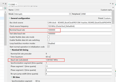

Currently working on LPC5536uC for one product.
Through the Zephyr LPC5536 was getting configured to internal 96MHZ FRO.
But with the help of clock and pin tool on MCUXpress IDE I made changes to use the external clk via PLL and drive the main clock to 150MHz.
I see in the config tool that by default the CANCLKDIV value is 1 and hence CAN will endup getting fed with 150MHz in my case.
But for a 1Mbps on CAN, how much should be the CAN clock so that I can set the divider accordingly?

Hello @ja_lpc
You can choose clock source for CAN, then use CANCLKDIV to get Baud rate. About detail recommend refer to CAN demo under SDK, and
config tool.
Alice
2,620 Views
Hello @ja_lpc
You can directly config baud rate on configuration tool as below:
Alice
