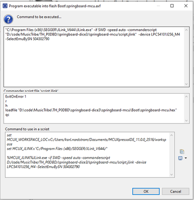

I am able to debug with the J-Link debugger and step through code, so I believe the debugger is connected properly. In addition, at some point in the past I was able to flash the MCU but I had to change computers and now cannot get it working.
I am using the GUI Flash Tool in MCUXpresso to do the flashing. Here is a screen capture of the command that is being sent.
I am running MCUXpresso IDE v11.0.0 [Build 2516] [2019-06-05]. We are using a slightly older version of MCUXpresso for compatibility reasons, but I have also tried the most recent version v.11.2.1 and received the same output.

karlin
Thank you for your response. I'm embarrassed to say that it was user error. We were connecting to the wrong debug header. All good now.
