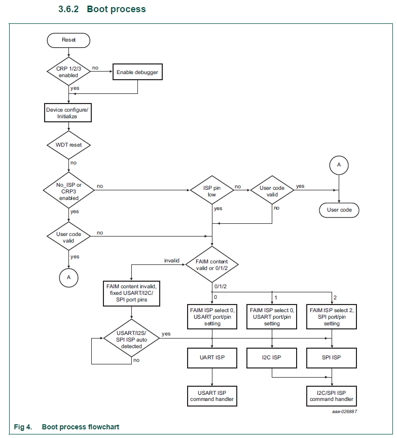

I am working on a host application, which will program a LPC84x MCU via ISP by the I2C interface.
From the user manual I can read that the FAIM register default value is ISP over UART.
So, how do I access the FAIM registers, to change it to use ISP over I2C?
Isn't it possible to program the LPC84x by ISP/I2C without having to access the MCU registers first?
Kaare

brendonslade
The LPC84x devices will boot from I2C under certain conditions. You really need to refer to the flowchart from the UM to understand this. For a part with invalid (unprogrammed) FAIM, I2C ISP boot should be working but at fixed pin locations (PIO0_11 for SDA and PIO0_10 for SCL); if the FAIM has been programmed (is valid) then FAIM word 0 bit 30/31 will determine if I2C ISP will happen (as opposed to SPI or USART):
Also... just want to let viewers of this thread know that the free Flash Magic tool includes a FAIM programming utility. Under the ISP menu, open FAIM to view the current FAIM settings and write new values. .
This doesnt solve the original request, but might be preferable to using the SDK or Code Bundle examples to set up FAIM. Note that FAIM has a limited number of programming cycles, so be careful!

brendonslade
Hi Kare,
I'm 99% sure the manual ought to say "invalid or unprogrammed" for FAIM in table 3, section 3.4 - you shouldnt have to go through that extra step for new parts. I'm checking this with the design team now.
regards
Brendon
8,814 Views
brendonslade
Ok - looks like the UM is correct ... you have to set FAIM to enable ISP mode over I2C (as Victor stated).

victorjimenez
Hello Kaare,
Just to confirm, you are right. The FAIM register is valid from factory.
Victor.
8,814 Views
victorjimenez
Hello Kaare,
Regarding your questions please see my comments below.
I recommend you use the example FAIM_and_Clocks  of the CodeBundle for the LPC845, to change the value of the bits 31:30 of the FAIM word0. If you are using MCUXpresso IDE you can find the code bundle in the following path: C:\nxp\MCUXpressoIDE_10.2.1_795\ide\Examples\CodeBundles
Unfortunately no, it's not possible to program the LPC84x by I2C without changing the FAIM values first.

kbk1
Hi Victor
Thanks for the fast response
But I don't like your answer :smileyhappy:
The example you point me to, shows how to change the FAIM from the LPC845 MCU itself.
This means that I have to have firmware in the MCU.
But, I don't want hat.
The reason to boot the LPC845 from a remote host via ISP, is to be able to boot the LPC845 directly from the factory.
I don't want to first program a dummy firmware into the chip, just to change the FAIM register setting.
As I read it, I have to use the UART to change the FAIM. This must be done in the factory, then.
And then I have to have the UART RX/TX exposed somehow.
And I must implement this in our production test facilities (which I hoped was not necessary...)
This was definitely not what I had in mind, and will complicate things a lot.
br
Kaare
