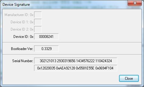

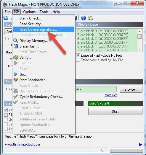

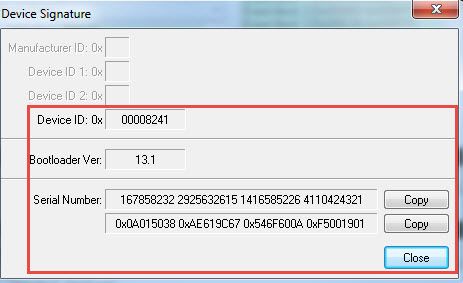

jeremyzhou
Hi Mark,
Thanks for your reply.
I'd like to recommend you to get the information about the MCU via Flash Magic tool, please go to download the tool via the link below.
Flash Magic - Welcome
You can get the these information via following sequence.
Fig 1
Fig 2
Ping
4,953 Views
jeremyzhou
Hi Mark,
I need to know the more information.
I was wondering if you can tell me the Boot code version via Read Boot code version command.
I'm looking forward to your reply.
Have a great day.
Ping
