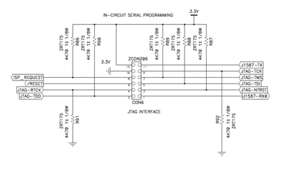

Hi good day! I would like to know which programmer I need for programming a LCP2366 using the following interface:

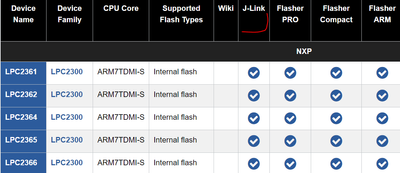

I was trying with a JLINK because I can see in the segger website that jlink is useful for LPC23xx mCUs
But, with the Jlink, I don't have the ISP_Request, J1587-TX and J1587-RX signal, so, maybe I need an adapter for using JLink, but I don't know which
ISP_Request signal is P2[10]/EINT0
J1587-TX signal is TXD0
J1587-RX signal is RXD0
Please, could you support me? Thank you

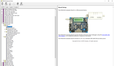

I suppose that you can use Keil tools to download code and debug with JTAG interface using ULINK 2 device.
In ISP mode, you can use FlashMagic tools to download code with uart interface.
