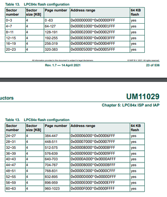

LPC845 has 64Kb flash memory but I see that only 0x0000 0000 - 0x0000 7FFF (32Kb) address range is described in Table 13/Chapter 5 of UM11029 user manual doc.
Are not last half of flash memory be accesible from IAP ?

I guess you are not using the latest UM
https://cache.nxp.com.cn/secured/assets/documents/en/user-guide/UM11029.pdf?fileExt=.pdf
this version fixes it
