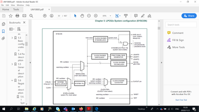

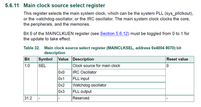

Your  colleague said that you use the internal clock source, can you tell us the value of MAINCLKSEL reg? it determines the clock source of the system clock and IIC.
XiangJun Rong

Hi Rong,
I used Internal IRC oscillator.
Please find the below code of initialization of clock.
when we increased the frequency to 440khz than we are getting  400khz.

From your code, you output the 12MHz IRC clock to the CLKO pin, it is okay, with the scope, you can test the IRC clock frequency. BTW, you can output the main clock to the CLKO pin and test it's frequency. The I2C clock frequency is main_clock/[SYSAHBCLKDIV*I2C_CLKDIV*(MSTSCLLOW+MSTSCLHIGH in MSTTIME reg)].
Hope it can help you
XiangJun Rong
