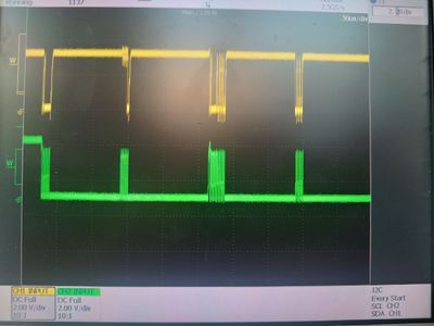

I have a really strange problem and i don't know what i am missing.
I am trying to use an I2C communication to read a sensor. So every transfer command , if read or write,  starts with a start command which contains also the slave address, followed by a write command in case there is a certain register which should be read and so on.
My Problem is:
When i am trying to use the I2C Interface in my own project, there is always a huge time gap between this sub-commands.
I made i picture to show my problem. Green is SCL(Clock) yellow the SDA(Data).
(I2C timing in own project)
The point is, when i am using the examples given by the SDK the I2C communication looks normal like this. All sub commands stick together as one can see at the small gaps between the Clock (green)
(I2C timing with example code)
There must be a configuration or something else i am missing.

> My Problem is:
As already mentioned, the answer to your question is already in the title.
You would have to check what other tasks are running in your application.
However, I would not be worried, unless you really need a high throughput.
A realtime OS allows you to do several tasks quasi-simultaneously, and to react to events in a given time.
This surely comes at the expense of runtime available to individual tasks, and complexity.
My company for example uses a similiar RTOS for our ECU, initializing devices on multiple CAN busses, and processing CAN messages at runtime at a certain time tick (10ms).

> I used a plain template project without any tasks than the i2c tasks, within a I2C_RTOS_Transfer. Also checked, if the normal I2C_Transfer and the I2C_DMA_Transfer are having the time gaps. All the same.
Most probably it is the scheduler alone creating this gaps - and perhaps FreeRTOS interrupt handlers. If I remember correctly, FreeRTOS grabs control over most interrupt handlers.

When you use FreeRtos to transfer data, there are semaphore or event mechanism to synchronize, so you will take a long time.
For example, this is the code, the line /* Wait for transfer to finish */
(void)xSemaphoreTake(handle->semaphore, portMAX_DELAY);
you need a longer time to transfer than that of without FreeRtos.

You are totally right, but the big time gap is not existent in the freertos_i2c sdk example.
I figured out that i cant reach the total 2.9 MHz I2C baud rate in the example, probably because of the FreeRTOS overhead (semaphore etc.), but i am not certain about that.
My solution now, is to build my project on top of the freertos_i2c example. It is a way around the problem but extremely unsatisfying
