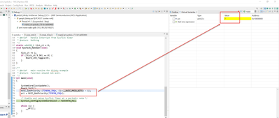

Hello @hbxiao168
I tested with lpc4337(the same with lpc4357), use below code, it can works well:

Hello @hbxiao168
You can directly write the Interrupt priority.
If you want to use "NVIC_EncodePriority()", you need refer to the function code and ARM manual to check how to use it.
