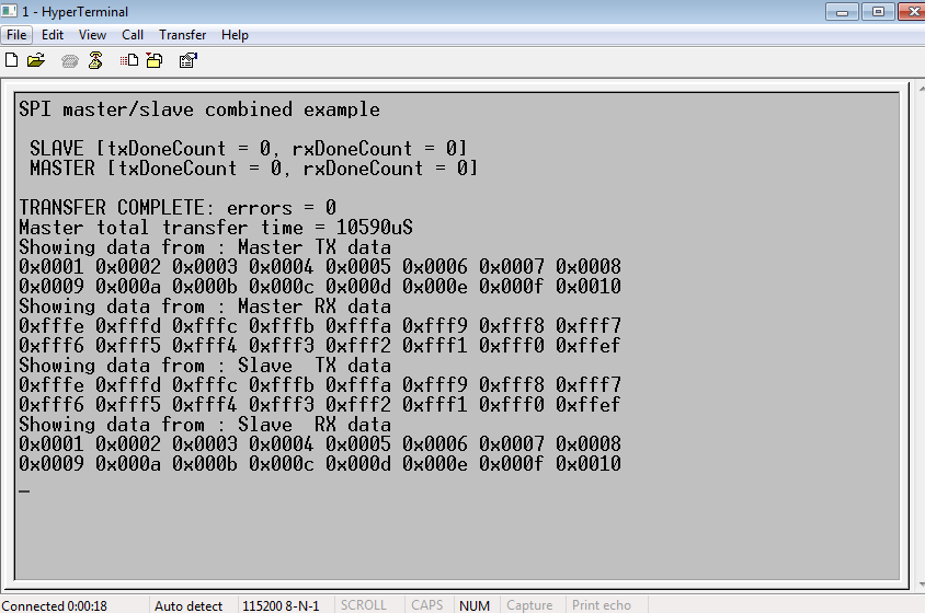

Then build and test it in the lpcxpresso LPC54102 board, I can get 21Mhz SPI, and the data is correct, this is the test result and the SPI wave.
I also attached my test project for your reference.
Kerry

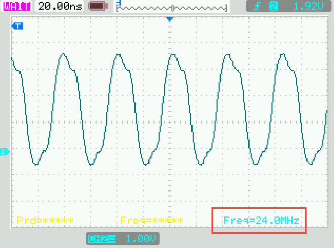

  It's still the clock problem, the logic analyzer tool sampling rate is not enough, the clock rate is measured wrong.
  I check it with the oscilloscope again, the defined 21Mhz baud rate, actually , the output spi clock is 24Mhz.

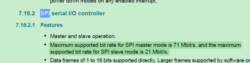

As you know, the LPC54102, the maximum supported bit rate for SPI slave mode is 21Mbit/s.

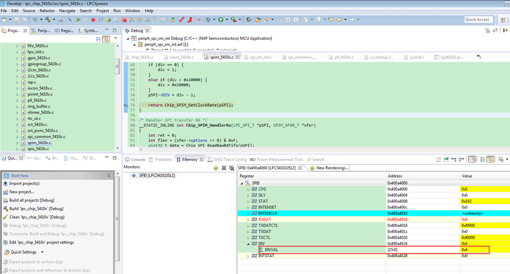

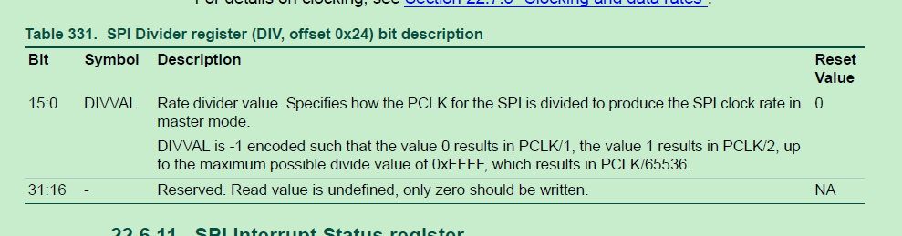

But the core clock is 96Mhz, if you debug the code, you will find the SPI divier register is 3, the divider is 4.
Divider 4 will cause the SPI clock rate to : 96M/4=24Mhz.
So, it already exceed the maximum supported bit rate for SPI slave mode.

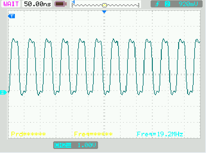

Then the core is 96Mhz, and it is the source for SPI module, then the slave spi max bit rate is : 96MHz/5=19.2Mhz.
So, I configure code:
#define LPCMASTERCLOCKRATE                 19000000
It will set the divider register to 4(divider is 4+1=5), the debug data is:
Then I check the clock rate in the oscilloscope, it is 19.2Mhz, just as defined.
The terminal data is:
You can find, if the master clock is in the range of the slave maximum clock, the transfer data is correct.
If you meet the similar problem in the DMA SPI mode, so, please check your clock configuration like me. use the oscilloscope to check the spi rate, whether it is correct.
