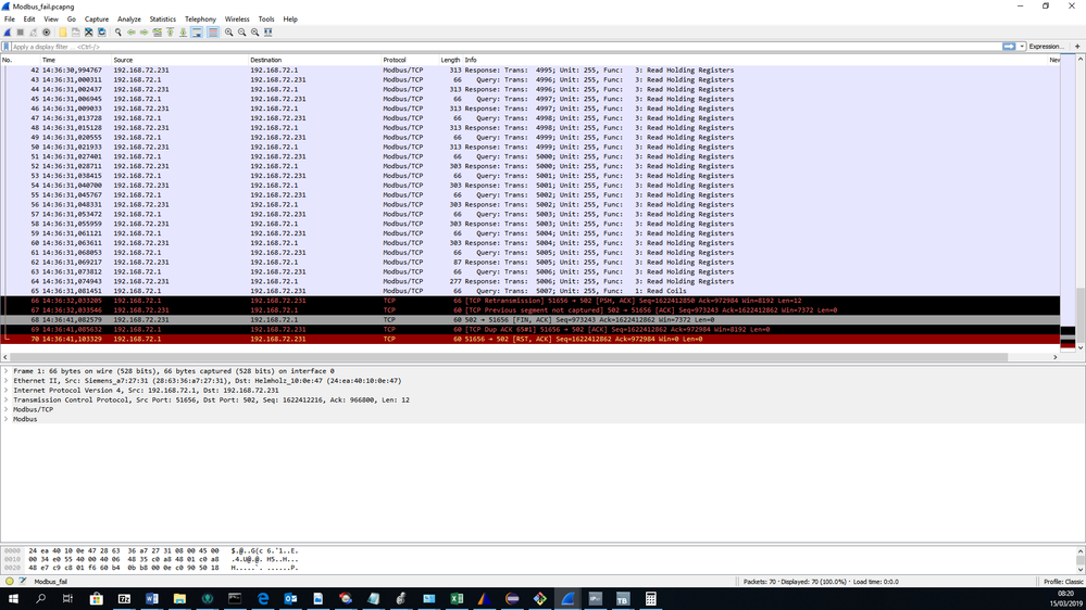

ankish_sharma1
Hi jeremyzho,
You are right the segment is not available in the trace because it hits the underrun breakpoint before it for debugging and the wireshark trace is from the firmware without a breakpoint introduced in it for Tx underrun interrupt.
And I am wondering why the lpc lwip driver not retransmitting the segment which had caused the underrun in the driver
if you can help me on this

jeremyzhou
Hi ankish sharma ,
Thanks for your reply.
I'm not clear with your reply, whether you mean the trace is recorded in debug condition and without placing any breakpoints, is it right.
Just according to the trace, we're hard to jump to the conclusion that the issue is related to LPC driver, it may be related to Lwip library
In the current, above all, find out the rule of replicating the issue, otherwise, it's hard to think out some ideas to fix it

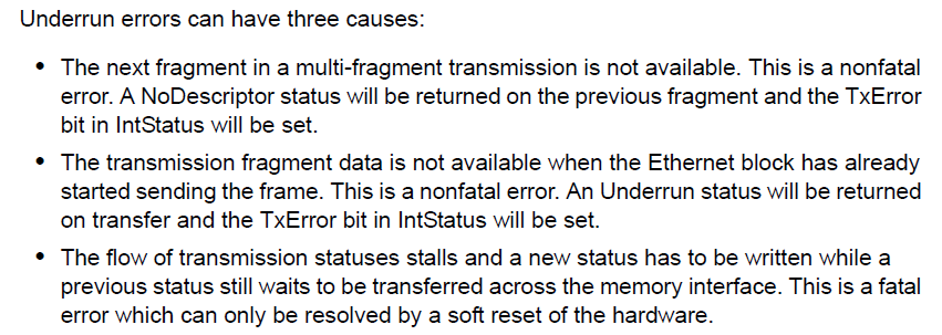

ankish_sharma1
What do you mean by testing on Data Link Layer?
I am looking for an explanation for the ethernet communication process in LPC
I tried to figure out the process from the user manual of LPC 1768 but its not very clear for me to debug my issue
Which is very much related to the ethernet MAC driver
As far as I understood the transmission process it works as
/* Save size of packet, descriptor is not last */
lpc_enetif->ptxd[idx].Control = ENET_TCTRL_SIZE(q->len) | ENET_TCTRL_INT |
ENET_TCTRL_LAST;
lpc_enetif->txb[idx] = p;
Activating the packet transfer complete interrupt in control register
Also the last segment interrupt activated
lpc_enetif->ptxd[idx].Packet = (u32_t) q->payload;
Packet section is uploaded by the payload
idx = Chip_ENET_IncTXProduceIndex(LPC_ETHERNET);
and the TXProducer index is incremented to indicate the TXConsumer buffer maintained by the hardware to consume the packet and send it out on the datalink layer
and after the segment is been send by the hardware it triggers an TxDoneInt interrupt which is been handled in the ETH_IRQHandler
My question is :
If the hardware segment transfer is only triggered by increasing the producer index how is it possible than there is an TXunderrun which is according to the user manual
The transmission fragment data is not available when the Ethernet block has already
started sending the frame. This is a nonfatal error. An Underrun status will be returned
on transfer and the TxError bit in IntStatus will be set.
It will be very helpful for mw to debug this issue if you explain me these points

ankish_kacktwan
Hi I am using Lauterbach script for debugging the firmware
It is a Modbus server communicating with a Modbus client at 100mbs ethernet link with lwip stack in it.
It works fine for couple of hours but then it shows me random delays of approximately an 1 sec which causes the Modbus client to retransmit the data
I am not getting any trace of packet drop even after debugging the lwip stack for sometime so i suspected it to be a emac driver issue so i put a break point in the ethernet port form the  Lwip demo in the LPCOpen library ethernet IRQ function where it gets the tx underun interrupt.
I have attached the Wireshark trace for the mentioned delay as well 192.168.72.1 is my Modbus client and 192.168.72.231 is my lpc 1768 Modbus server with lwip stack for tcp/ip communication.
void ETH_IRQHandler(void)
#if NO_SYS == 1
 /* Interrupts are not used without an RTOS */
 NVIC_DisableIRQ(ETHERNET_IRQn);
#else
 signed portBASE_TYPE xRecTaskWoken = pdFALSE, XTXTaskWoken = pdFALSE;
 uint32_t ints;
 /* Interrupts are of 2 groups - transmit or receive. Based on the
    interrupt, kick off the receive or transmit (cleanup) task */
 /* Get pending interrupts */
 ints = Chip_ENET_GetIntStatus(LPC_ETHERNET);
 if (ints & RXINTGROUP) {
  /* RX group interrupt(s) */
  /* Give semaphore to wakeup RX receive task. Note the FreeRTOS
     method is used instead of the LWIP arch method. */
  int_rx_cnt++;
  xSemaphoreGiveFromISR(lpc_enetdata.rx_sem, &xRecTaskWoken);
 if (ints & TXINTGROUP) {
  if (ints & (ENET_INT_TXUNDERRUN | ENET_INT_TXERROR))
   tx_error++;
  /* TX group interrupt(s) */
  /* Give semaphore to wakeup TX cleanup task. Note the FreeRTOS
  int_tx_cnt++;
  xSemaphoreGiveFromISR(lpc_enetdata.tx_clean_sem, &XTXTaskWoken);
 /* Clear pending interrupts */
 Chip_ENET_ClearIntStatus(LPC_ETHERNET, ints);
 /* Context switch needed? */
 portEND_SWITCHING_ISR(xRecTaskWoken || XTXTaskWoken);
#endif

Hi ankish sharma,
The underrun error would happen by these causes, just according to your description, it's hard to say which cause you may encounter.
So I'd like to suggest you do more test to find the exact cause, in further, LPCOpen library has provided the Lwip demo, you can refer to it for details.
