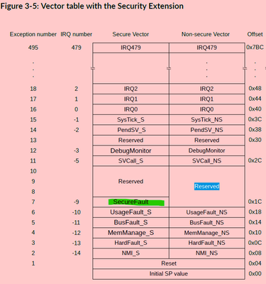

Hello, I apologize for the late response I reviewed the ARM Cortex M33 documentation but I couldn´t find any related for the checksum. Seems like the user_code_checksum is an implementation by the Linker.
But I notice this on de document page 59 there is a Figure 3-4 Vector table without security and Figure 3-5 Vector table with security. If you notice the SecureFault use the next reserved area.
I recommend a double check on the ARM documentation.

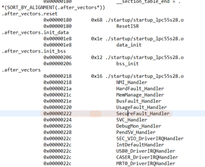

andrewjfox
Hi Pavel, thanks for quick reply.  No this is different to what I'm seeing.  The attached image is from my hex file, and shows the entry at 8th location, which I expect to be the user checksum, but is definitely not. It is 00000223, which is marked in the map file as address of SecureFault_Handler. The SecureFault_Handler is also in the startup file, supplied by SDK. It looks like the linker is not placing the checksum in the vector table, but placing the SecureFault_Handler instead. Is this an option I can change? Is it specific to the LPC55 only ?  The bootloader must not be checking the vector table like for other NXP parts because it would fail.

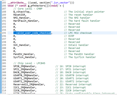

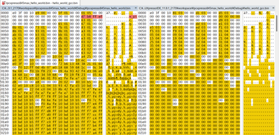

Hello, I think is the same issue that I show on the image, let me share this information maybe could help you.
This is not an issue by the GCC, about the checksum issue, the checksum is added by our code in startup file. It doesn't relate to the complier. I have check MCUXpresso SDK demo, it added the checksum in startup and linker file. Please check below figure.
