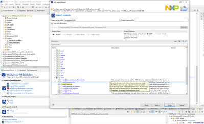

1,698 Views
xiangjun_rong
The SDK has the example of uart in interrupt mode, pls try to run it and check if there is issue.
I suggest you have the uart to transfer char repeatedly, then check if you can receive the char or check the waveform of the uart TX pin.
Hope it can help you
XiangJun Rong
